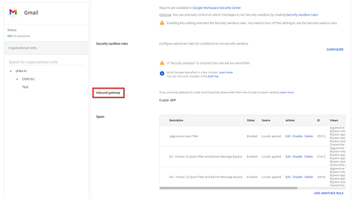

Inbound Gateway
Inbound Gateway is feature in Google Workspace to be used when email has been pre-processed in some way. It’s most often used when a third party mail filter in place. For Infosec IQ, we implement this policy to prevent our phishy emails from being put under the microscope for their large volume.
- From the Google Workspace Admin dashboard, click Apps > Google Workspace > Gmail > Spam, Phishing and Malware.
 - Click Inbound Gateway and check the Enable box
 - Add each of the Infosec IQ sending IP addresses by clicking Add under the Gateway IPs section. These IP addresses need to be added individually.
 - -Optional- It is not required to check the box that says Require TLS for connections from the email gateways listed above. We recommend it as it will provide a more secure channel of transport for our emails but it is not necessary. If your organization already has IP addresses in the Inbound Gateway without TLS required we recommend not changing your current configuration, You may leave the other three boxes unchecked
Note: If your organization is already using the Inbound Gateway for other purposes, it’s still possible our IPs can be safely and successfully added alongside your existing policy.
- Review your settings against the image below:
 - Click Save
